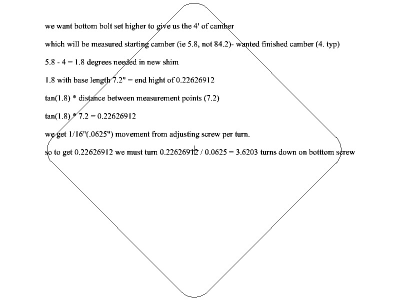

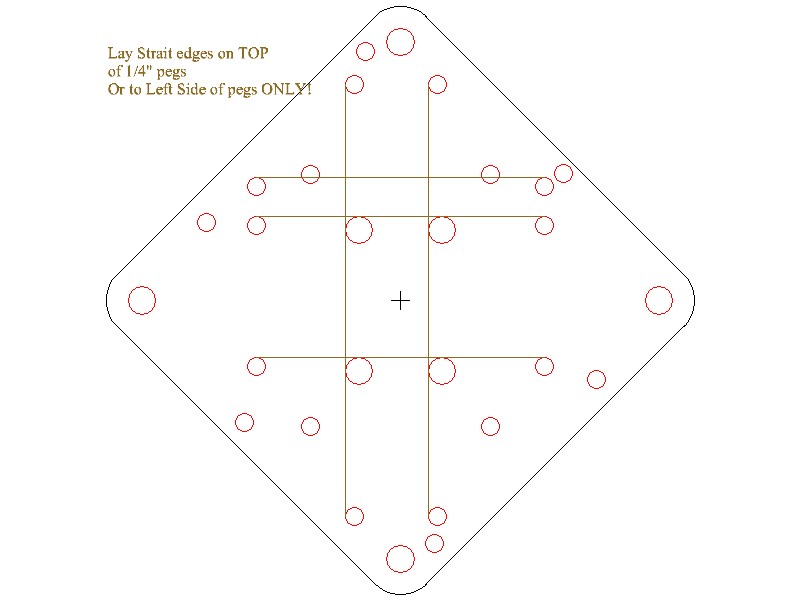

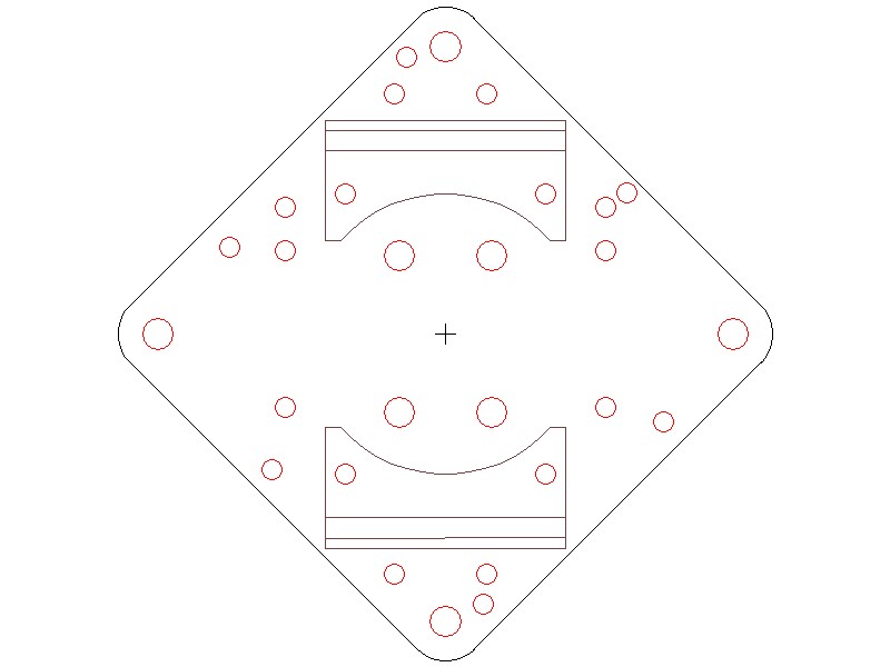

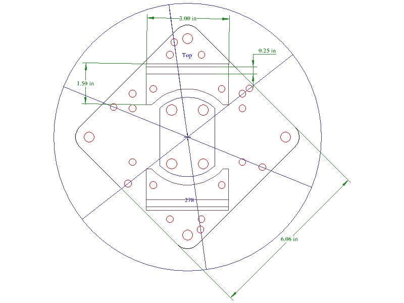

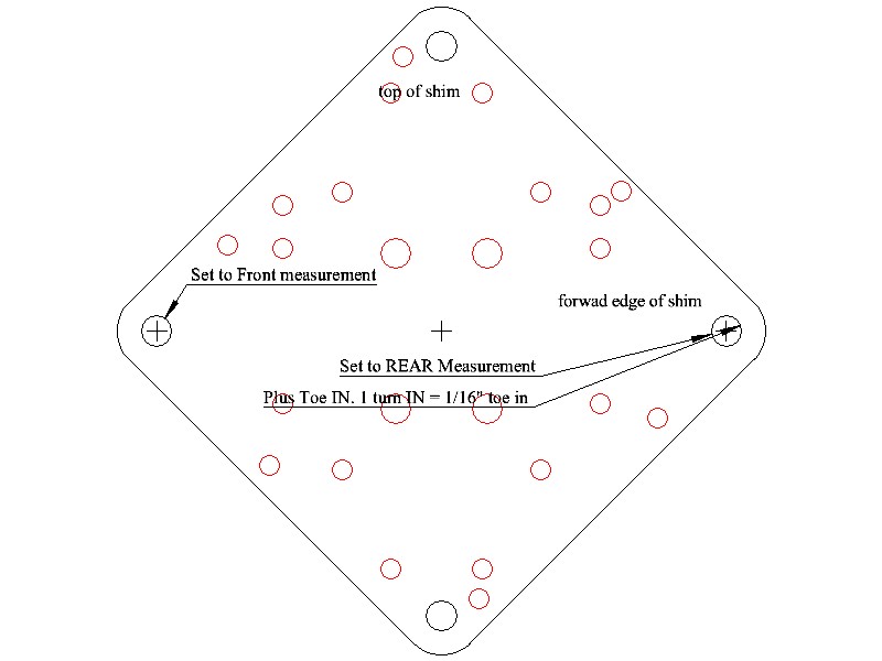

    the new spring gear shim jig....
    I'm glad I posted this, I found my instructions! didn't think I had written them down....
    much easier to use, no math involved the tilt screws are 16 threads per inch, so each turn is 1/16" adjustment and are spaced apart same as Cleavland type rim, so if you measure 1/4" toe you just adjust appropriate screw(which is opposite of where you took measurement)..
    also, one thing to check before measuring... they say lay strait edge against front of tires... but i always check for one gear trailing back from damage, by measuring equal distances out from center of plane on strait edge to a point in center of belly by tail of fuselage...(if one leg is back and you don't do this plane will track to on side)
    remember to remove all shims from axle before measuring....
    and full pictures are in my album http://picasaweb.google.com/mike.skup/AroundTheShop#
    and if anyone wants to build one, I have the real cad files somewhere, then if you have a cad program that can read them, then you can print out full size patterns on white stick label paper and just stick it to your raw metal and punch through it....

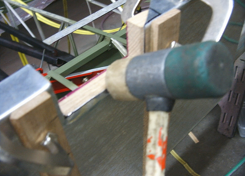

    magnetic straitening tube blocks...
    this was before I thought of adding magnets in blocks... had to fumble and tape them on....
